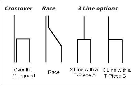

    A couple of bits ... That were time consuming ...
    New hoses
    I should have went for the racing two line kit, but never mind ...
    A bloody good clean
    Titanium bolts, vortex sprocket and a good clean of the chain
    Pretty happy with how it's looking ... Rearsets on the way and then will install along with pillion peg removal.

    Bikes looking very nice mate, can I ask you why you said you should of went for the racing 2 line kit? The reason I'm asking is I intend to fit new lines on mine and not sure what the racing 2 line kit looks like or is it that they would of been easier to fit.

  10. Mr OCD
    Mr OCD Well-Known Member
    Nov 9, 2014
    2,300
    511
    It would have just looked a little less messy at the caliper that's all.
    The OE pipe has a joiner that mounts to mudguard and then splits a pipe to each caliper. The HEL hoses run one line straight to the caliper and then a line from the caliper to the other side via a double banjo...
    The two line kit basically runs two lines straight from the master cylinder to each caliper.
    However I had a lot of trouble mounting the new line to the master cylinder as so little space to move so mounting two lines with a double banjo would be a nightmare room wise.
    Saying that bleeding the setup I used was really easy and the lever is rock solid.
    I might move the HEL labels just to tidy it up ... OCD kicking in again lol
    HTH
    • Thanks Thanks x 1

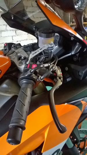

    Hmmmm Brembo RCS 19
    Such an improvement over the stock master cylinder
