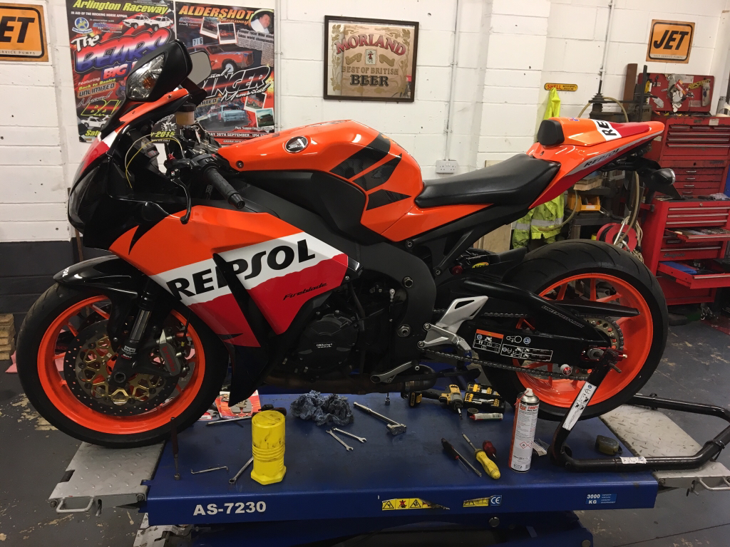

    Fitted

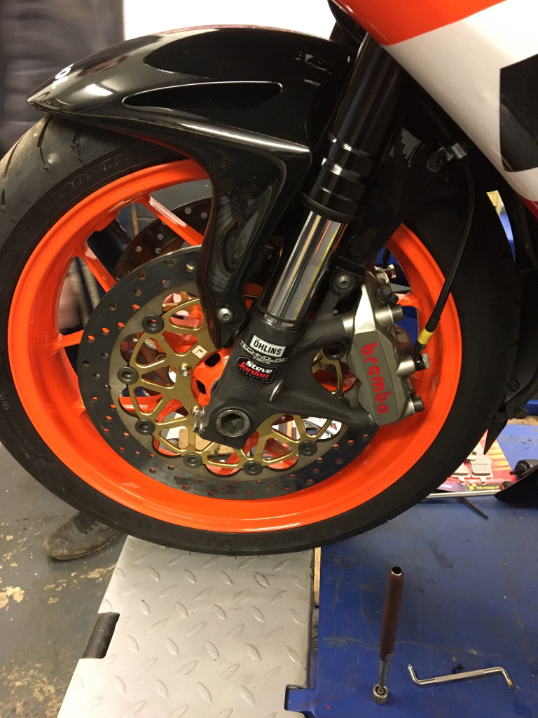

    Brembo M4 calipers
    HPK discs
    Annitori qs (Bluetooth set up one) this is a job I will never do again.
    Oil and filter
    Sp seat cowel
    Still to do
    Fit super corsa tyres
    [​IMG][​IMG][​IMG][​IMG]

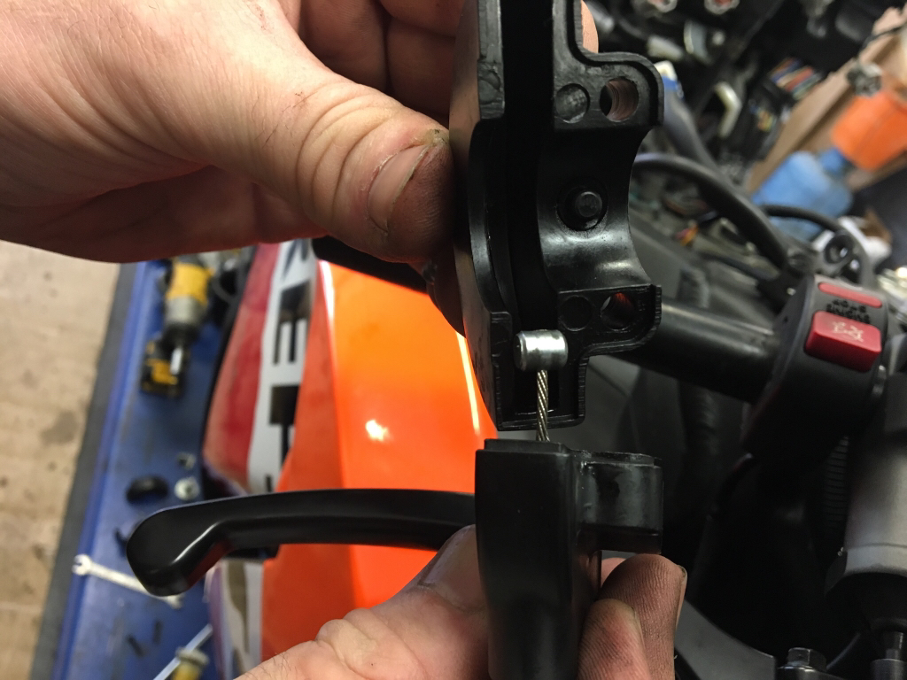

    And HRC Qat, the standard cables are to far for the new housing by the way

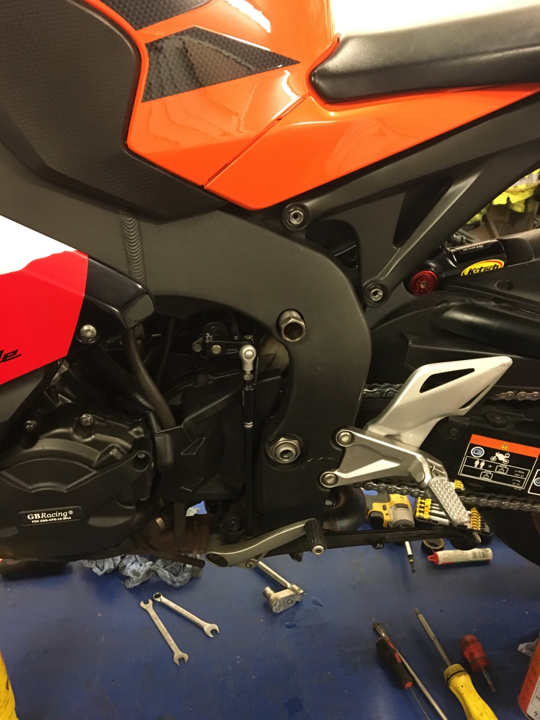

    Chain and sprockets to

    Did you have to get the longer cables gor the throttle?

    Standard cables are spot on. The HRC kit from Dobles came with a new housing which was a lot narrower than the existing one. I just used the oe housing with the new tube. It's fine

    So you only need the throttle tube then?!

    For me yes, my bike was a 13 plate.
    I did have to undo the cables at the throttle body end though, as I was fitting a shifter at the same time it made sense
