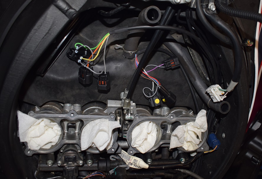

  9. Nigel H
    Nigel H Active Member
    Jun 26, 2018
    213
    220
    Well I'm still Quick-Shifter fitting.
    I've got all the cables nicely dressed into the space under the air-box.
    I've taken the opportunity to move the Scottoiler, the GPS and the camera cables into that space as well running them out beside the throttle cables so it's getting awfully tidy.
    But now I need to 'fold back' the rubber sheet to get access to the plugs.
    It doesn't want to come.
    It seems to be held down all round.
    All the documentation seems to assume it's simple and obvious.
    I don't want to just pull hard, it isn't that sort of material.
    What will it be snagging on?
    Please can somebody explain why it really is simple and obvious and it's just me being a ding-bat.
    Please....

    I have been in there twice now on my bike and as I have a poor memory couldn’t give you a step by step guide. However I vaguely remember it tucks under the air intakes and possibly has like a double sided sticky tape holding it in place. Don’t remember it causing me a problem, but you’re correct in pointing out it’s not the kind of material that would withstand brute force. I found I had to loosen off the left fairing and pop the air intake out a bit to get access to the left coil. If you go down this route it may better reveal how the rubber sheet is held in place. Take it easy, you’ll get there.
    Maybe someone with a better memory than me could chip in.

  18. Nigel H
    Jun 26, 2018
    213
    220
    YES!
    OMG what a horrible piece of design. You glue something that is inside the frame to the outside of the frame under an air duct that is under the fairing.
    I've done one side but my space is a bit confined so I need to move things about to get the other side apart now.
    The next time it comes back from a service and they list new plugs I shall not be surprised at the labour hours.
  19. Nigel H
    Jun 26, 2018
    213
    220
    Oh that wonderfully satisfying click as the last plug latches home (pull, wiggle, s'ok) and now the job is just putting things back together again.
