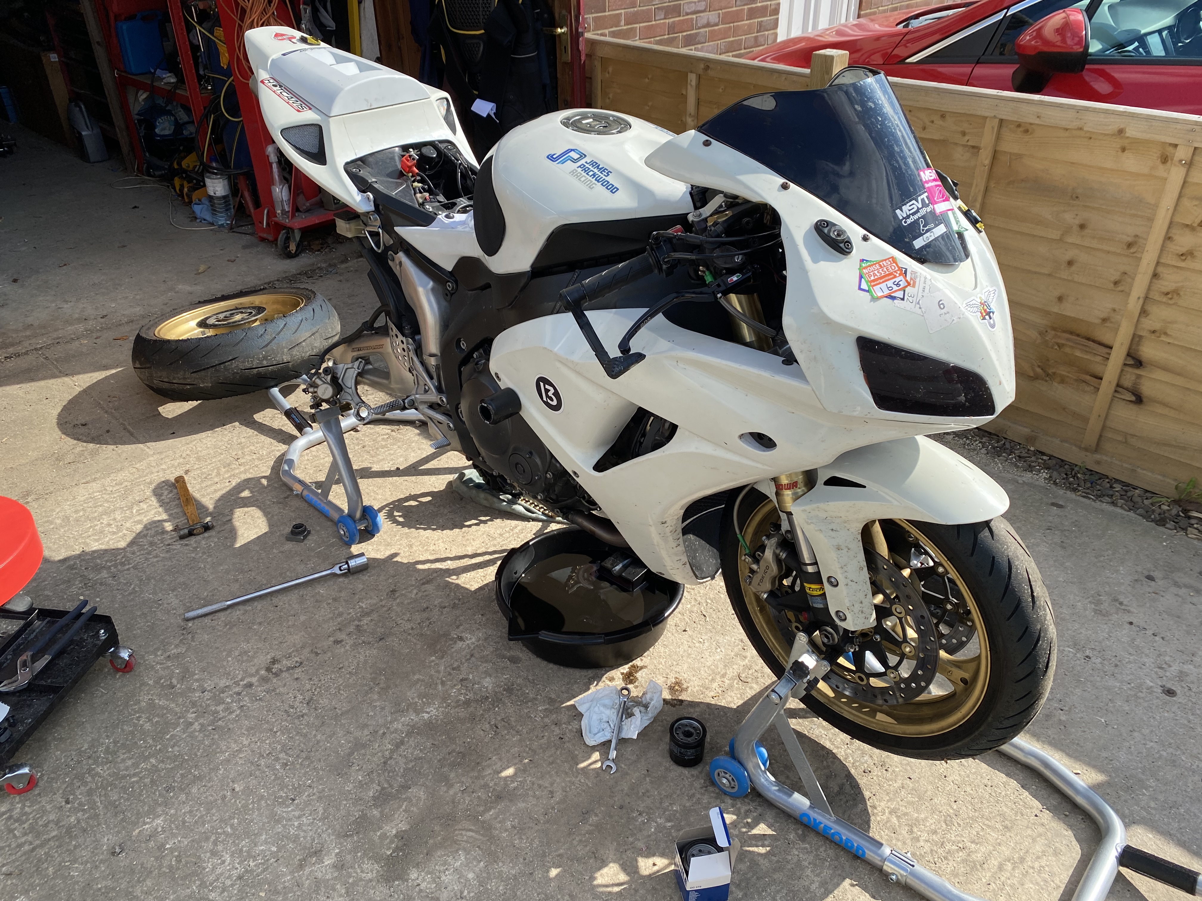

  8. dern
    dern Well-Known Member
    Apr 11, 2017
    633
    566
    Serviced the track bike. New rear tyre, oil and filter, brake and clutch fluid...

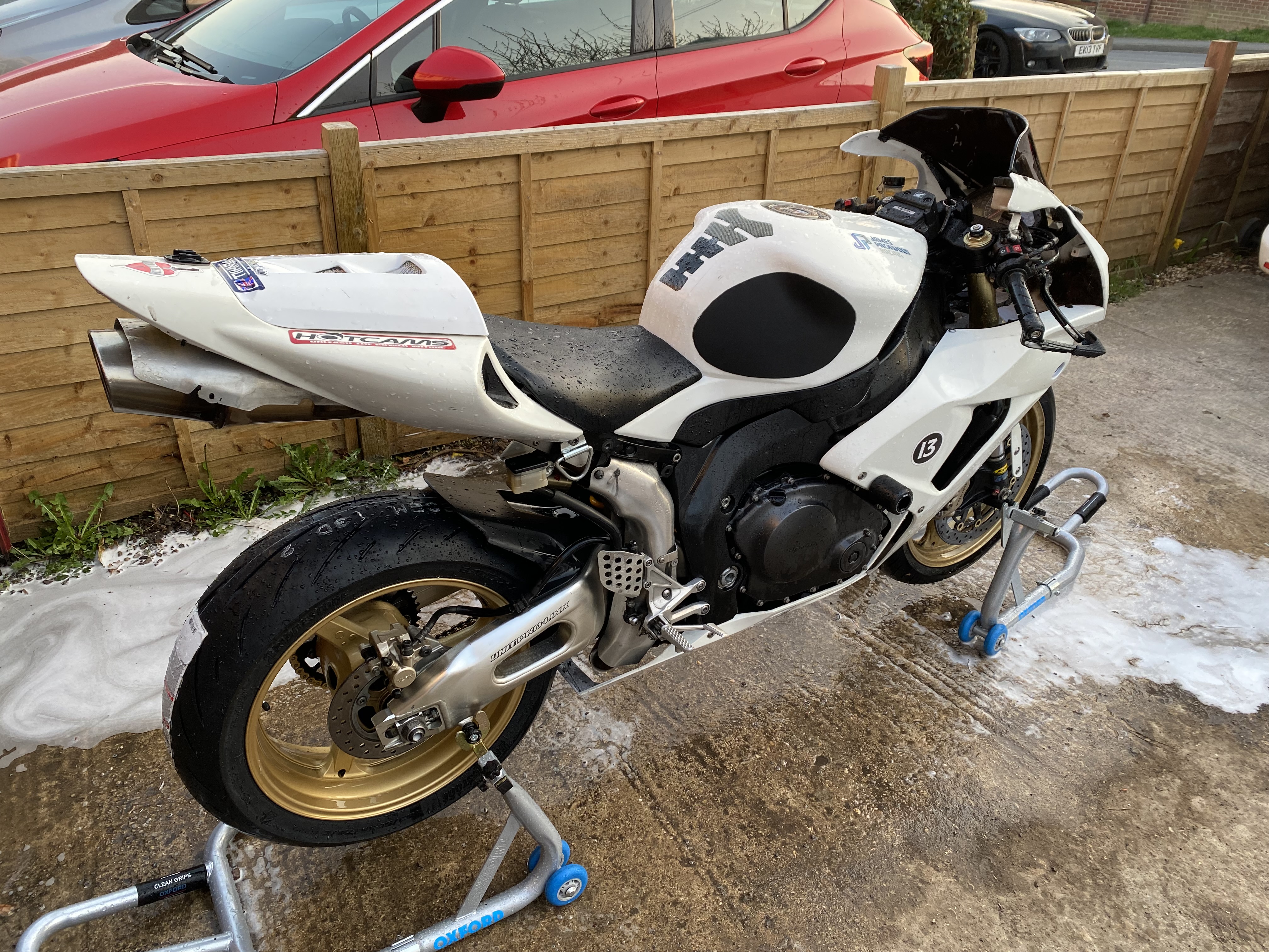

    C81EC3A8-C30D-4DE7-8E9E-A78D884ABF3A.jpeg Gave her a clean and got her through the MoT for another year.
    • Like Like x 6
