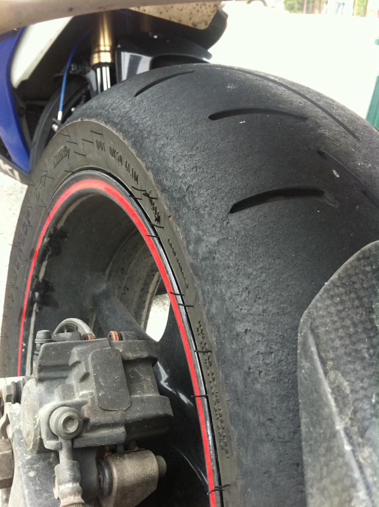

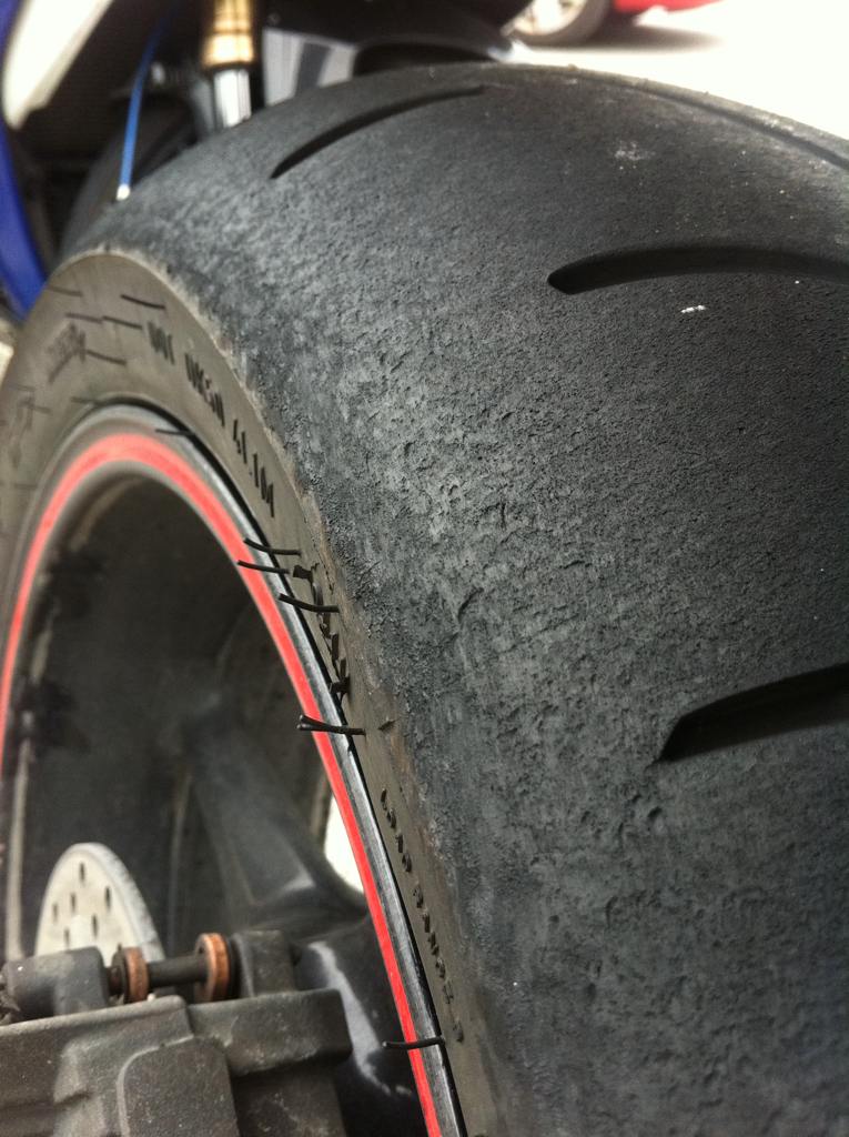

    Doesn't look to good to me Sam, looks like you need to give your suspension settings a check over. Tyre looks ripped to me, honestly mate. It's great that the 55 gives you confidence but on the road it should look smoother than that.

    I agree Steve, cold ripping together by using low pressure as well dude.

    I take it thats when you were running 32R for it to tear up near the center like that
