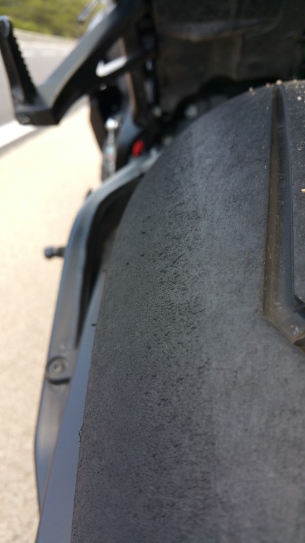

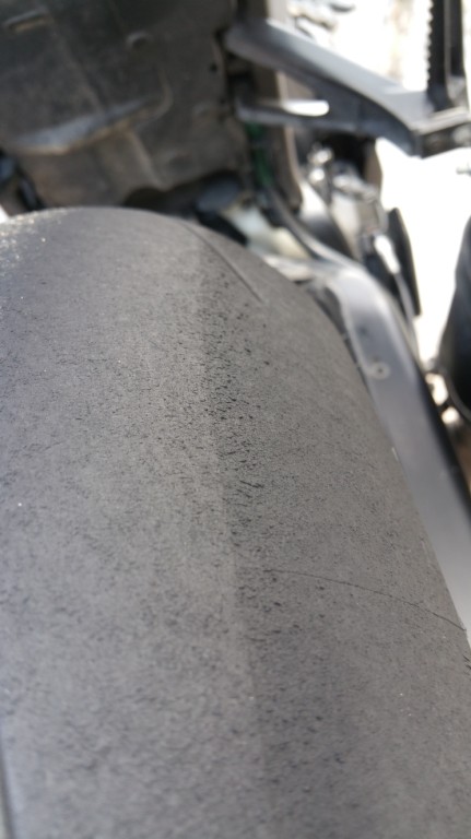

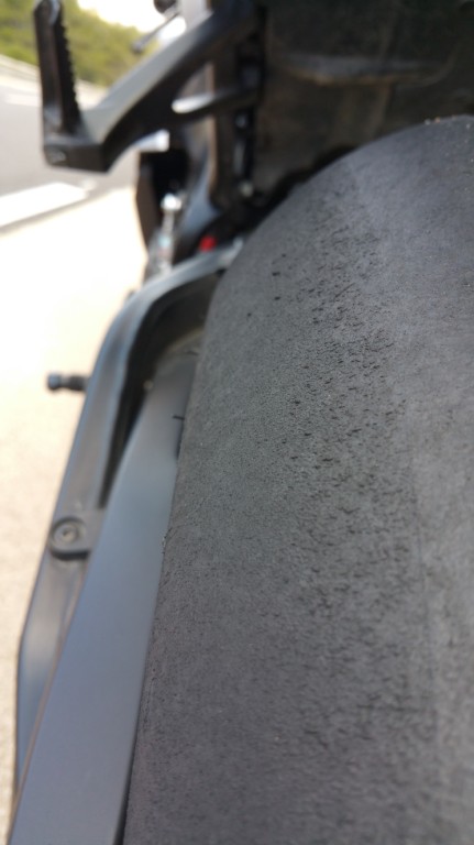

    Ok I got round to trying the D212pro, these are the french made (not uk hand builds) but agree they have loads of grip, was impressed, they are soft front (2) and Meduim hard rear/ (4)
    put 31psi front off the track, and 24psi rear off the track (22 out the warmers, and 19 cold)
    not sure about how long they will last, so not sure whether to swap back to my Pirelli Rosso 2 road tyres until next day (guy only charges £24 a pair to change)
    here is a pic after 60 mins iin track (3x 20mins sessions)
    does that wear look about right?

    Tire wear looks spot on, which means that the rear shock has been set up correctly.
